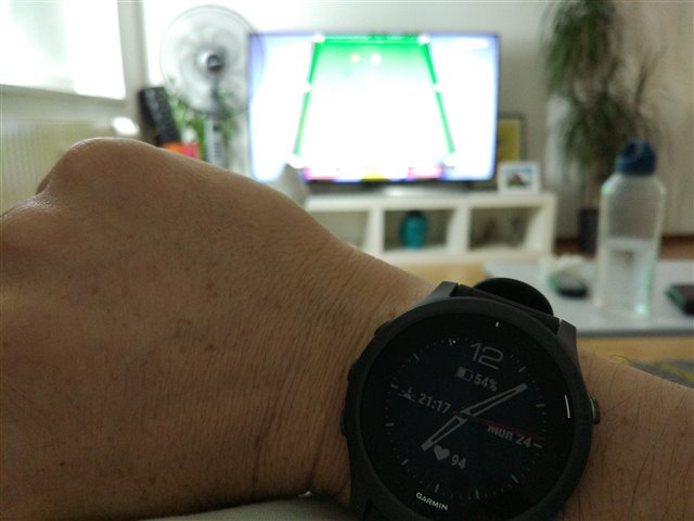

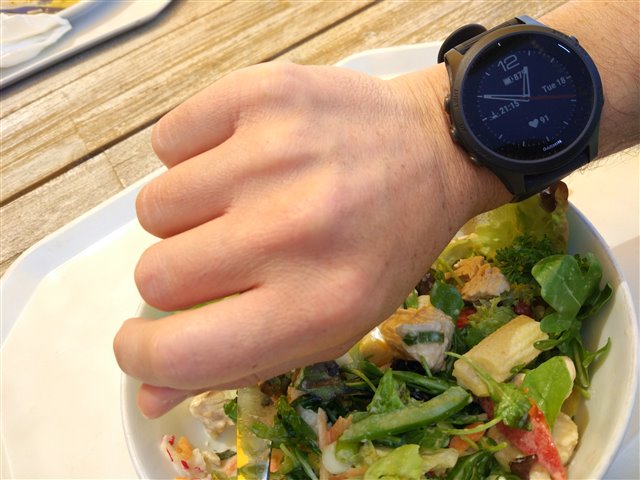

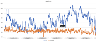

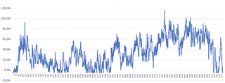

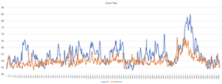

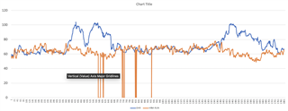

Anyone else experienced issues with the heart rate inaccuracy? My FR945's HR reading is often higher than actual by 10%-30%. Usually when walking or moving around (e.g. cooking or talking & moving hands). It is disappointing because my $200 Fitbit tracks my heart rate accurately. This is a critical feature, because many other calculations depend on it.
Resetting the sensor (with garmin's support) did not fix it.
  • I'm really wondering if (a) my sensor is faulty (b) no one else is looking at HR much (c) people don't have a feel for what their HR should be in certain daily activities...
    Here are just two examples of close to double the expect HR during (almost) complete rest:
    Stable 90-95bpm 10 minutes into a lunch:
    90-105bpm after 30 minutes of couch potatoing:

    Your "B" and "C" questions are biased. You're assuming that everyone should be having the same issue as you and the rest of us are oblivious to what's happening. You very well may have "A" going on, but let me add the possibility of "D", that most don't have the issue, or "E", the 945 just doesn't work well with you personally, such as fit, sensor placement, etc...   From the photos, the watch appears to be a little large for your wrist. I recall in the past you had an issue with pace on your 645?  Did HR work better for you on that watch?
