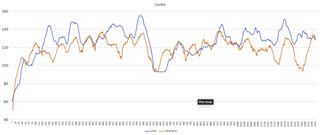

  • Tal,
    Thanks a lot for this comparison.
    From my POV - the results are embarrassing..... and totally shows what I feel and see while I use the watch day2day
  • to me, as i said, is totally useless. i use it every day to do upstairs workout. When i reached the top floor the ohr read 102bpm.... the 920 with the chest strap read the real ones… 168bpm....
    why the 920xt? because as i said the 945 firmware 4.40 kill the 3 straps (yes the 3 i have) connections so the 945 is only a *nice* watch. Waiting for a new fix for connection in the upcoming firmware.

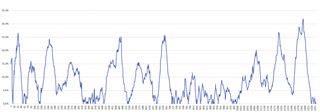

  • A 22 minute HIIT workout:
    Gap %:
