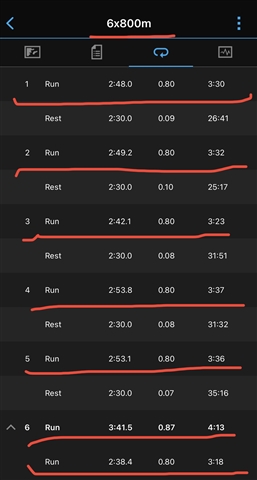

My FR 745 does not include a "Rest" on the last lap of intervals, it just goes "Workout Ended" right away.
For example, when I create a workout on the watch:
Run > Training > Intervals: Run 6x0.80km / Rest 2:30min
Lap 1: Run 800m > Rest 2:30min
Lap 2: Run 800m > Rest 2:30min
Lap 3: Run 800m > Rest 2:30min
Lap 4: Run 800m > Rest 2:30min
Lap 5: Run 800m > Rest 2:30min
Lap 6: Run 800m > Workout Ended
The worse thing about this issue is that the watch does not show the time of your (run) last lap, and also the time still keeps going untill you press stop.
This only happens when I create the intervals on the watch itself.
On the other hand, if I create a workout on the phone and send it to the watch, this problem does not occur.

  • Hello Brooks,
    Thank you for your kind response.
    I don't mind to have a cool down at the end, so it can act like a rest.
    However, there's still one problem remains which is when I finish the last run/lap, the watch does not show the timer of my last run/lap - it just displays "workout ended" or "cool down" right away.
    This is really bad since I always put all out effort on the last run/lap and I want to see the timer right away - not to wait and view in the summary later on.
