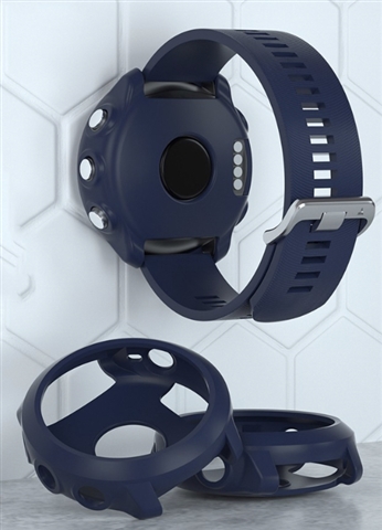

    I had bought a black 645m soon after its launch ,March 2018, about 4 months ago noticed hairline cracks on plastic lungs near the pin steel holder- based in APAC- no replacement/out warranty. Searched and found TPU protector ( much like phone case), online shops for 5$,very tight and sung fit ( a little push/shove/stretch to get the watch in), but holds very well. Though watch slightly bulky, not any heavier, doesn’t spoil the looks much, button are now nearly flush with case , however it took few days to get used to and best part the shop has different colours  to.match ! AND most importantly, the hairline crack hasn’t expanded any further and holding the lug and pin securely.-extended life !.
