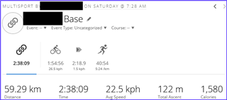

Today I did my first Brick workout via Garmin Triathlon Coach on my Forerunner 570.
Prerequisites:
Bike activity has Auto Pause enabled.
Steps: I was approaching the end of my bike leg and stopped a couple seconds before the end of workout -> Auto pause is ON -> Press Lap button -> "Until Lap Press" screen appeared -> Press Lap -> Complete Run leg -> Save.
Please check this issue, otherwise it would be not possible to use the coach plan comfortably.
