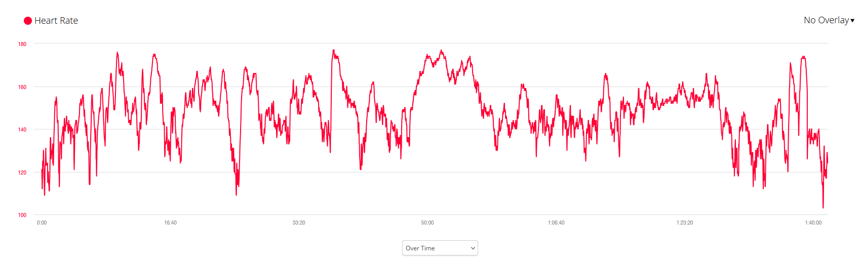

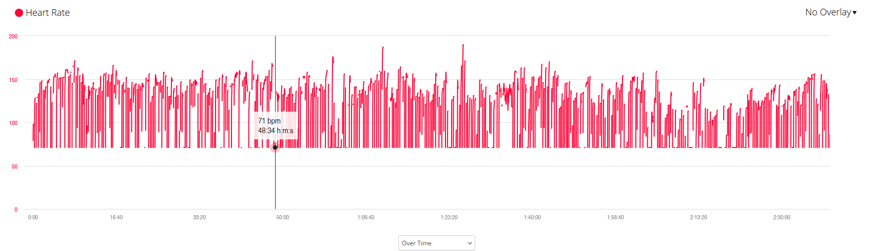

I've included images of 2 heart rate graphs below with the first image being the erratic behavior and the second being from a normal ride before this issue began. Both are recorded using an HRM Pro Plus, the watch, and an Edge 540 bike computer.
