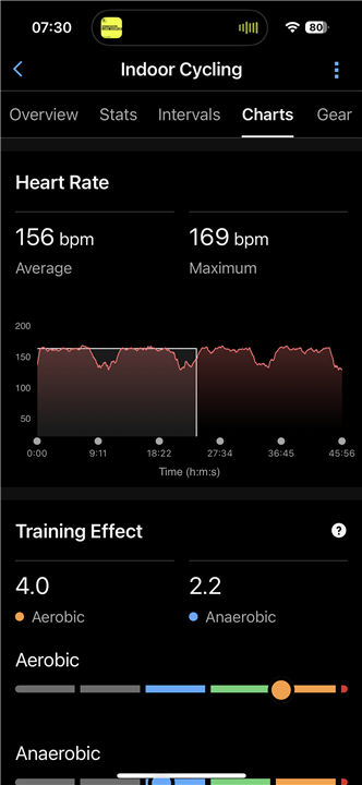

I have done two self-made workouts using HRM Pro and FR265.  After the workouts when viewing the HR chart, it shows a white line which I think is supposed to be the target HR along with the actual HR data. (Only included picture of one workout)

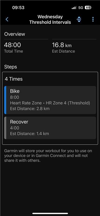

The issue is the white line goes straight across the chart and suddenly makes a right angle to the bottom of page about mid-workout. It’s an interval workout and target HR is zone 5  and no target for the recovery periods.
Is the problem because I didn’t program a target HR for the recovery periods? I didn’t want a target in case I wanted to use zone 2 & 3. Is it a bug in the system? How do I fix it?

    It cuts off at 24 minutes because you set the HR zone to 8 minutes 4 times. So after the 4th time for that 8 minutes each is done, the white zone cuts off because you are no longer trying to hit it. If you set the repeat by 6 times you will see that white line go for the whole workout making it 48 minutes long (6 times 8). All looks correct to me with our algorithm and how you set your workouts! It does not count the recover time as you don't have any set HR zones. Happy to help more if you have any other questions!
  • 24 minutes is only half (2 rounds of 8+4) of the planned 48 minute workout (4 rounds of 8+4). The white line cut off after 2 rounds, not 4. Shouldn’t the line cut off after the last (4th) interval? I didn’t keep doing intervals beyond the planned workout.
