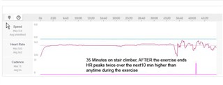

2. 35 minutes on a stair climber. After the exercise ends I kept the watch recording and over the next 10 minutes the HR peaks twice to a level higher than at any time during the exercise and then drifts down in what looks like a repeatable pattern

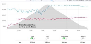

3. A 5k run with a stepper hill. At about .4 miles in the HR does a straight up vertical jump from 126 bpm to 150 bpm!
