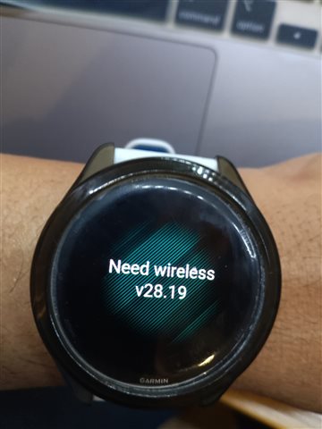

Hello, I updated my watch yesterday. Today, December 6th, it won’t let me sync, and I get the message: "Need wireless v28.19." Is anyone else experiencing the same issue?

Yes, same here and I tried everything suggested here and on Reddit. Won't work. Very frustrating.
Solved this issue: How to fix this annoying issue on the ForeRunner 255 (Music). You have to go into the secret menu: menu > settings > system > about > press the upper-left button repeatedly (8 times) until…
I have the same message and issue with forerunner 965.
I am having same issue since today with forerunner 965
I just got a notification with a QR code for downloading an actualization. Hope this will fix the issue. Check yours, for sue you´ll get it as well.
Solved this issue: How to fix this annoying issue on the ForeRunner 255 (Music). You have to go into the secret menu: menu > settings > system > about > press the upper-left button repeatedly (8 times) until the display changes > reinstall software...go for it! This did the trick for me. Hope for you guys too ;) watch out for future updates, and don't forget this solution!!

It is the upper left button, not the upper right. Getting more and more disappointed Garmin......
I apologize for the typo. I've edited my steps- thank you.
