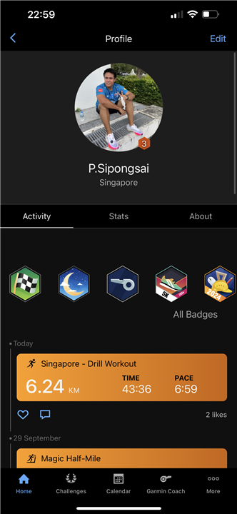

  • Hi thanks for reply, im not sure that i have set an intensity target, because i have follow the 10k program only . But you can have a look in my profile.. anyway, could you help to advise me how to set an intensity target ? Thank you
  • It looks like your drills do have an Intensity Target for your cadence. I'll reach out and get a report made. Thanks again!
