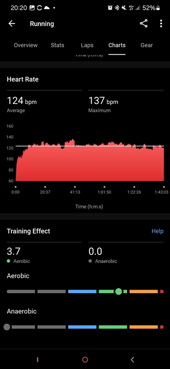

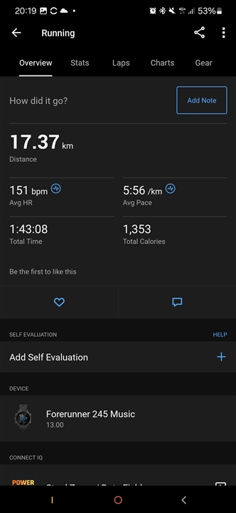

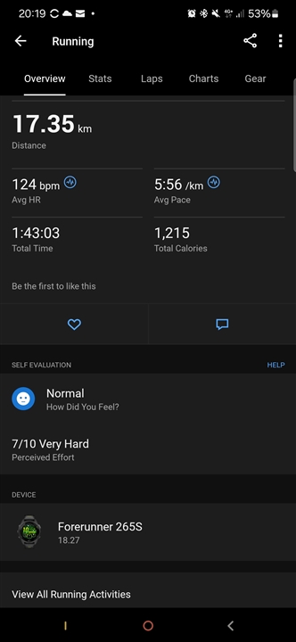

  • Went on a 17 k run yesterday. To see check the reliability of the HR readings I wore both the 265 and 245 (ridiculous that I need to do this). Wore the 265 tightly, 245 tightly too.
    Vastly different readings and given my effort levels I definitely think the 245 was the    more accurate. Garmin you need to wake up and stop wasting peoples money

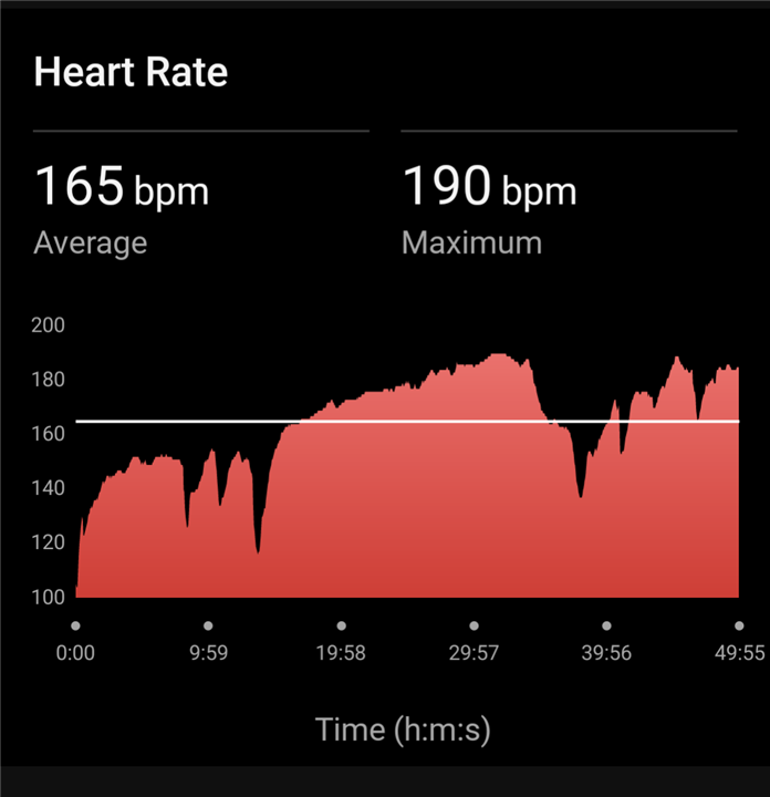

    i can confirm its the watch tightness is affecting my HR.
    1. Here is my floors climbing activity I just did.
    I tried a hole loosened and climbed lap #1.
    HR was very low throughout lap #1 until I tighten up. HR started to pick up after lap #1.
    I did 5x laps of 19 floors each.
  • I don't know for certain but highly suspect it is the case.
    *given historic data from 245 over the years for similar runs at similar effort levels
    *also given that when I purchased the 265 in May 2023 the data was very similar to the data I had been getting from by 245 in previous years. Only since Jan 2024 the heart rate data for my 265 has seemed very off.
    Also the data you are showing is from floor climbing. From other threads seems like this issue for some reason is mainly affecting running, possibly cycling too.
