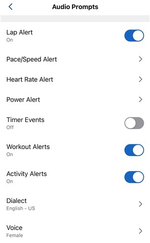

  • Keep pressing down when you get to History and more options appear - Activities, Appearance etc etc. Then select Audio Prompts, scroll almost to the bottom and you get the Dialect and Voice options
  • "Indicaciones de audio" is "audio prompts" in spanish app/watch, as you can see there is nothing similar as "dialect".
    Just to compare, look at the "regular" screen until last update and compare with the ones posted (by David and me) and also happens on watch menu, there's nothing to configure. (white is from garmin manual, black is my screenshot), all options below "power alert" are gone:
    In my case I can't hear anything at all, in David's one he listens everything in english and cannot configure dialect.
    Previously we had configured in spanish and it was working properly, i don't know if this problems happens also with other languages.
    • inside audio prompts only LAP, PACE, POWER and HEART ALERT. Another options, including dialect, has gone.
