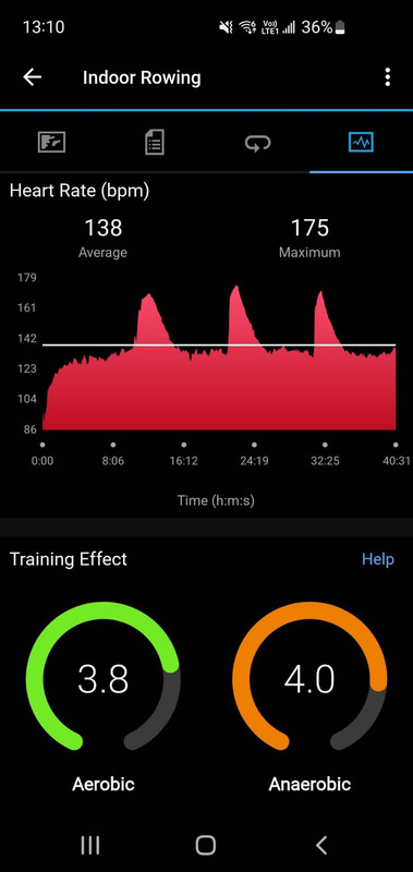

Below is is the result of my 30' rowing machine session at the gym this morning.
In my watch, Max HR is set at 172 and Lactate Threshold at 154.
So I tried rowing bringing my HR to about 154 as you can see from the chart, and every 5 minutes, pushed harder for 1 minute.
I presume that the Anaerobic benefit I got comes from the 4 big pushes I gave above the Lactate Threshold, and the rest would be Aerobic, correct ?
But then as you can see, it says my Aerobic training is in the Overreaching territory, at 5.0.
If I want a bit more balanced training, for example 4 and 4, instead of a 2.8 and 5... what do I need to do ?
I'm a newbie and obviously am missing something.
Thanks !

    0 Former Member over 2 years ago
    Thanks for the responses guys.
    As a follow up, I went back to the rowing machine today and got quite close to the 4 and 4 I was looking for. If I had known, I would have rowed an additional 10 minutes. I guess it doesn't really matter. I also notice the watch notified me that it increased my Maximum HR to 175. The 3 peaks are 2 minutes long each.
  • got quite close to the 4 and 4 I was looking for.
    Thumbsup
    Good to see, that it works the way we suggested. Have fun.
