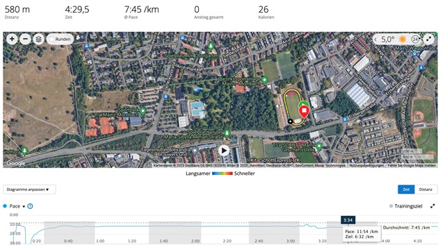

But as I read that there's a fix "related to structured workouts" in the Software Update 14.17, I gave it another try today and created a "Test-workout" in which I hoped to not find the bug or at least discover any structure...
Basically that's how I create my workouts, I just put in a slow (walking) pace to be able to focus on what the watch is doing:
Unfortunately even after the Software Update, I experienced several bugs:

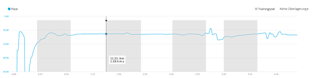

Fist of all there's a drop in pace to zero during the "Warm-Up"-segment, although I never stopped walking.
The the first "Recovery"-segment was exactly 34s instead of 1min.
Second "Recovery"-segment was 30s.
The third one only 17s.
What is funny though: In the overview, Garmin Connect is convinced my "Recovery"-segments ("Erholung") all were 1:00min, what is definitely wrong (see above).
There seems to be something really wrong and I'm wondering if it's my watch, I'm making a stupid mistake or do others also experience this big? If anyone of the Garmin Team is willing to have a look at the data in my account that would be highly appreciated!!!

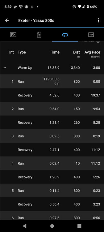

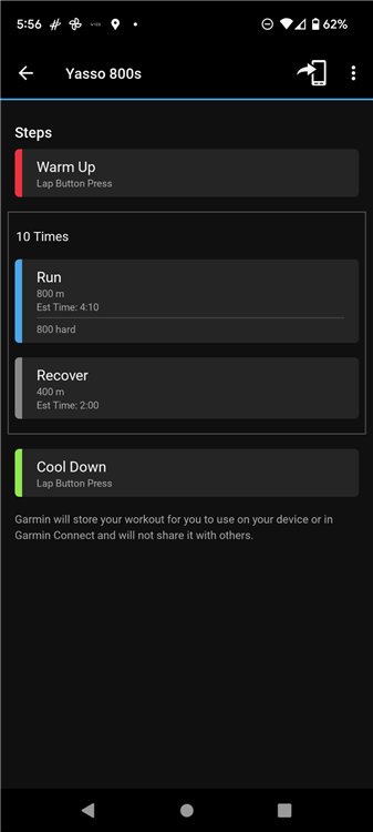

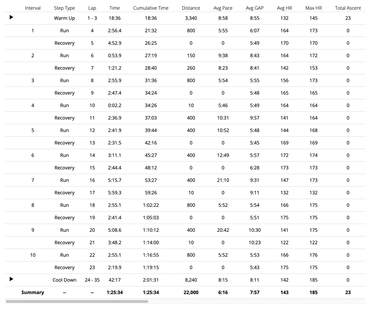

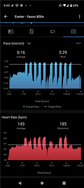

  • I am not even sure how to explain my bug, so I will just expand on this one.
    My 5k PR is 23 minutes. This workout was no where near max, with more rest (due to bugs) than work intervals. Realistically, I only recall doing 5 intervals, even though the watch was set for 8.
    Distance should have clocked in at +-5k.
    I am guessing it was GPS errors that was smoothed out by track mode? But I was running SatIQ mode on an open field track, with no trees or high buildings to block signal. Also, the GPS track shows 0 signs of any deviation from the track. It should snap out if it wanders for more than a km from the track?
    https://connect.garmin.com/modern/activity/10629075807

  • Your average pace is 3:59, while your average grade adjusted pace is 6:20. Quite interesting, given that the total ascent of the entire workout was one meter. The watch indicates that you had a quite a few rests with average pace zero. They contribute to your low average pace, despite having a distance of zero.
