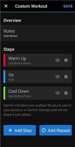

So I created a Cadio Workout in the ConnectIQ app.
Simple workout with warmup, some circuit intervals and cool down.
