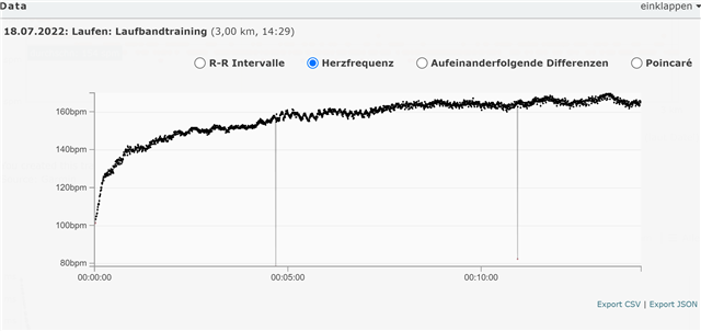

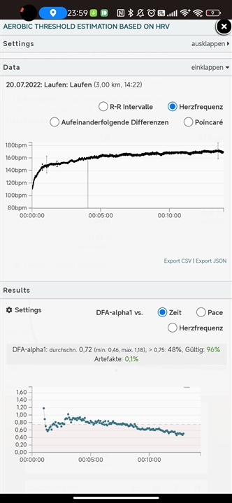

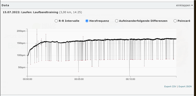

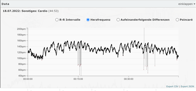

2 weeks before I find out in the Software Runalyze that I get 5% artefacts in the HR measurement, like in the attachment. I also attached a fully correct screenshot with 0,01% artefacts with the same HW constellation. When I run with a belt witch is connected via Bluetooth or ANT+. I get the problem with two HR sensors where one of it has a brand new belt. With the HR sensors is everything ok.

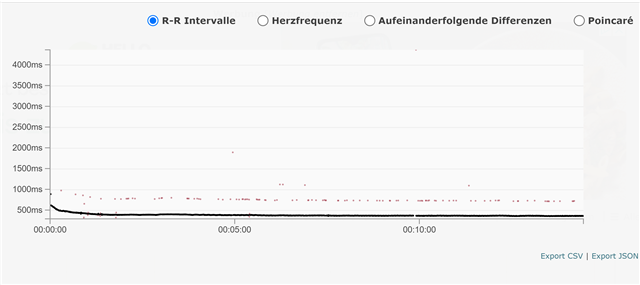

I measure the HR and HRV over the HR belt and send it to my FR 245. Over the SW Runalyze it is possible to show the dfa alpha1. If I get more than 2% artefacts( wrong HR, see attachment) the measurement is not valid. The wrong HR is always in the same range and only the SW was changed from my FR in my setup.
