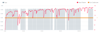

Hi everyone. I've got a new 245 and on Connect my pace is missing occasionally within a run, and my cadence is zero. But bizarrely the resulting map is fine, the total mileage is accurate, and the watch counts my steps towards the daily goal.
See below: I was actually moving about 7:30 min/mile throughout the entire activity -- no long standing break near the end. How do I fix this???  Also, the orange line is my cadence, solid zero through the entire run.
Here's a segment of the resulting run.  The blue lines correspond to the dropout sections of the run graph above. So the watch knows I was moving geocoordinates but it can't communicate the correct pace data to Connect.

  • but in the 1st pic you posted the cadence isn't zero for the whole run it's only dropped a few times for a few minutes (at least that's what I assume that the cadence is the gray shadow, because the picture is so small I can't read anything on it)
  • In the first pic, cadence is the orange line which is a flat zero. Red is HR, and the gray/shadow element with the dropouts is my pace. The pictured run was 80 minutes, so the longest pace dropouts near the end covered about a 10 minute span.

  • you might find this interesting:  Here's a graph of my steps for that day. You can see the lime green line which are my accumulated steps during the day, which increases by about 15k steps during the mid-day run that I posted images above at the top of the thread. So yes indeed the steps are being counted even though Connect is reporting a cadence of zero (orange line in first image). Weird!
