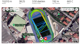

When I check the KM... It is 10K is ok.. but the trace of the map is inaccurate... How should I believe the run I made was 10K... Should I have to count every 400m. lap ?
And in addition, it shows the elevation is 192m. In track??? I'm in east Europe and was using GPS+Galileo.. once I tried the GPS+Glonass and it was the same result too...
Any advice, please?
  • 1. Set GPS settings to "Every second" instead of "Smart" (loaded by default) in Data recording. 2. When GPS signal is locked, stay still (do stretches, etc) for 1-2 min. before run. Trace will be more accurate.
    Elevation 192 m is because GPS signal reflect from or trace on map goes thru buildings near the track.
