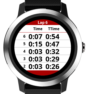

    Hey, I have a couple of free Connect IQ data field apps that you can add to your Run activity which show you all your laps with the data of your choice (up to 3 columns), including cumulative time.
    I can't help you with the inability to see cumulative lap time after you've saved your run and are reviewing laps in the activity history, but maybe one of these data field apps will help during the run (and immediately after the run, before you save it):
    Lap Viewer (lap list only): https://apps.garmin.com/en-US/apps/14e5c6b5-c9e8-44f9-a1ff-28a44148c170
    Lap+ (6 fields + lap list): apps.garmin.com/.../77c83bb1-925e-4323-a2ab-e97269c3cdb9
    Also, if you're looking for a simple stopwatch which can show cumulative (split) time (e.g. for track workouts), I've got an app for that too. (This one is a full app that replaces the Run activity):
    Stop and Go: https://apps.garmin.com/en-US/apps/38eddacd-e098-40ce-82d8-f45584b0a117

    Can't argue with you there, especially because data field apps (and apps in general) have a lot of limitations on Garmin devices. For example, data fields can't really accept user input, so I had to implement a crazy hack to allow the user to "scroll" through the lap list (you have to press UP, DOWN or DOWN, UP fairly quickly to switch to the next page.)
    I made those apps partly for my own use TBH, as I:
    - Want to be able to look at my lap list during an activity (e.g. interval workout)
    - Wanted a nicer version of the garmin stopwatch (with dark mode, clock, ability to switch the lap list from lap times to split/cumulative times, etc.)
    The thing I do like about Lap+ is it's a "single run field" (with 6 fields on one page), with the ability to switch to your lap list whenever you need to (while you're waiting for a red light, resting between intervals, etc.) There are other single run fields that are arguably better (like Dozen Run), but none of them have a lap list.
    If you don't care about the 6 fields, you can just download Lap Viewer, and it'll be slightly simpler to use.
