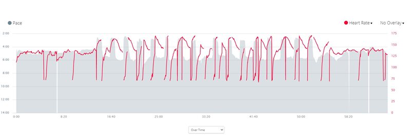

Can anyone shed any light into why my HRM-Run strap keeps dropping out for a few seconds after every mile. I have included the stats on my watch but since the start or middle of the year it has started doing this.
Do I need to change the battery or is this a software problem?

    I can't shed any light on why...but I am in a similar situation. My heart rate strap is also dropping out regularly and it is only a few months old. I am therefore guessing it's the software.
    It is very frustrating. Was running intervals today and dropped out 9 times in 18 minutes. Happens every time I'm running at a quick pace.
    Was using my Forerunner 220 for 5 years and HR strap was always consistent. My new 245M drops out regularly.

  • Former Member This was from yesterday. The first drop is off the warmup of 15 mins when I stretched and the watch was paused in the workout mode (so that was expected). The next one to occur was near the end of the workout (just after 7 miles) on the actual watch, giving me a workout ended message where I ran back home for an extra few mins. So I do believe it's all software related. I was the same as you, my HRM is not old and the batteries do last a long while. But this result with the new battery is far better than I had been getting.

    You can see from screenshot how many times it dropped yesterday:

  • Out of curiosity, is this happening at lap intervals. In other words, do you have auto-lap set a 1 mile and each time it ticks over, it drops out? If you change the lap interval, or manually hit the lap button, does it do the same thing? Some of the other responses makes me think it might be related. For example, if it is dropping out 9 times in 18 minutes while doing intervals, this would make sense if there were 9 intervals in that 8 minutes. And it makes sense if someone saw it when their workout was complete and the workout ended message shows, as that is recorded like a lap interval.

    For me at least I don't think it's linked to the autolap. I get what you're saying though and it's a good suggestion. There doesn't seem to be a pattern but rather it drops out at random times.
    For example I did a 6 mile tempo last week and it dropped out 4 times in the first 9 minutes, 4 times in the next 15 minutes...and was perfect for last 15.

  • This is a good point as I did notice that the auto lap in the workout mode would do this but again it was happening at other random points as well. Like last year it was all fine, I think ever since the software went above 4.0 this started to occur. I also wet the HRM strap thoroughly before use and most often using a high quality shirt or singlet so not sure it can be linked to the material before I start running naked Joy

    I have exactly the same issue (FR245M). It looks like it started appearing after the upgrade to 5.00. I have relatively new HRM (2-3 months old).
    Especially, when I doing interval training, the watch is constantly dropping the connection with HRM at regular spaces. Attached screen from training.
    When I connected this HR strap to old FR235 and run intervals everything was OK. I suspect a software problem.
