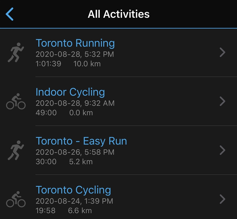

    As far as I know, an update didn’t happen overnight. It was 5.00 as of my last activity (see screenshot) and is still 5.00.
    I ran at around 5:30pm last night. The watch froze part way (as usual when trying to use PacePro on the 245, lol), but I restarted the watch during my run and it was able to resume the activity, though it didn’t get a GPS lock for a long time (see the long, straight line sort of parallel to the actual road I was on).

    could be related to the indoor activity without distance
    talking about the dots on the training load graph
    • do the last ones correspond with actual activities ?
    looking at the training status widget on the watch, any guess where it added the 150, low mid or high ?
