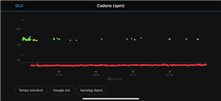

I am experiencing issues with my Cadence.
Somehow at certain moments it does not register the cadence correctly. IT appears that only half of my cadance is recorded ?
It appears that it is not constantly "wrong" , but as you can see below, for a great period during the run it was wrong.
And within the run below, I was constantly "running" so its not that I was walking or something.
I have seen similar posts where people were using a metronome. But I don't use that feature.
Does anybody have some tips to resolve this ?
