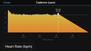

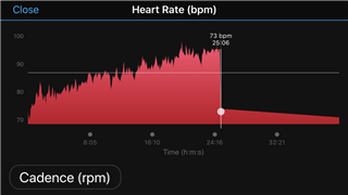

I bought my mother the forerunner 245 including new HRM & Cadence sensors, she is  training indoor on a bicycle trainer.
Since we bought it (maybe half a year ago)  we are experiencing a problem with both ANT+ sensors (HRM & Cadence.)
The problem is that after ~25 minutes of activity both cadence & HRM together fail. (As shown in the pictures bellow.)

Cadence sensor fail
