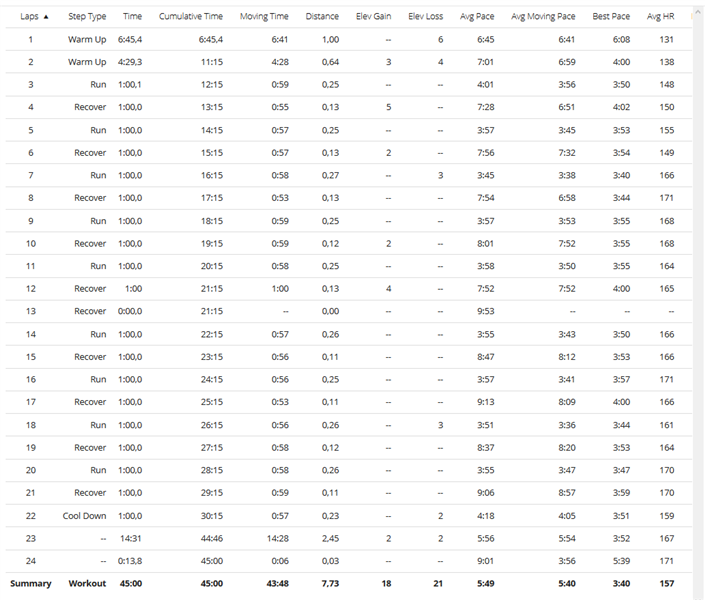

    The first was with a workout I built on Garmin Connect where I finished a 10x(1' run, 1' recover) workout and a lap was triggered immediately when the cool down began. This shows as a 0:00 duration lap immediately after the last 1' recovery period.
    It happened again today while doing a workout with the 245M's built-in Interval function. With warmup/cooldown enabled, I programmed 5x (4' run, 90" recovery) and it did an auto lap immediately after the second last 90" recovery which resulted in the final 4' run interval being skipped.
    It seems to be somewhat random (second last repeat, at the start of cooldown) so I'm not really sure how to workaround this except to go back to my old reliable Forerunner 220 for workouts... Disappointed
