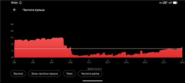

update: no more step tracking, sleep and inconsistent heart rate
Since the last update, the watch has become unusable: no longer sleep tracking, steps are no longer counted and the heart rate is completely inconsistent

    • Inconsistent HR readings: It stays between 72 and 80 BPM regardless of activity.
    • Tracking failures: It does not track sleep or HRV, which affects the recovery indicator (showing "prolonged" recovery due to lack of sleep data).

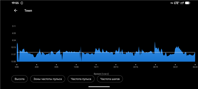

    During Activity (Running, HIIT):
    • Heart Rate issues: It does not track heart rate correctly (stays in the 72–76 range). I used an older device (Forerunner 245) simultaneously, and it displayed my heart rate correctly.
    • Input Lag: There is a 10-to-20-second delay when starting or stopping an activity after pressing the button.
    • Faulty Cadence: Cadence readings are very low, even when increasing speed.
    • Inconsistent Running Pace: The pace increases intermittently; it initially displays a low pace, then "jumps" or accelerates to catch up once the GPS updates the distance covered.

  • I'm seeing the same thing! And the issue has been consistent too - heart rate stays at 74-76bpm even if I push myself (or even if I know I'm staying at zone 2 but I know this is obviously not). Garmin fix this please!
