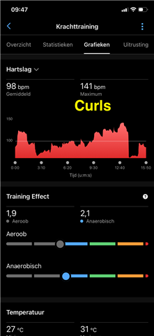

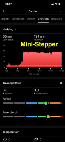

I notice some heart rate errors during some workouts, typically while doing simple biceps and triceps curls and my mini-stepper
Check the attached screenshots :
- Curls: modest 15' workout with 2 x 2kg dumbbells. My real HR was around 60-70 BPM throughout. The irregularity in the HR graph is crazy.
- Mini-Stepper: 20' workout. Here too my HR would be around 70 BPM. The sudden jump at around 6' is completely unrealistic.

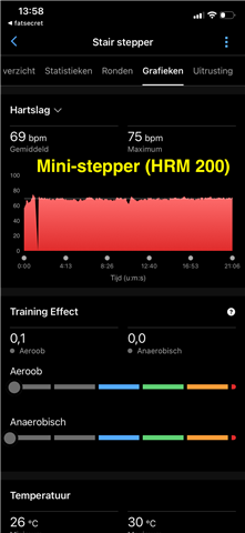

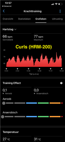

    I talked to Garmin Support, sent them the above screenshots - but they had no explanation other than "Get a Heart Rate Strap". While I did learn that curls can be a nightmare for a wrist watch to deal with, I have no explanation for the outrageous jump while on the Stepper. Anyway, after a number of emails with me insisting on a solution or even a hack, Garmin Support was kind enough to send me a HRM 200 for free. That, indeed, solved the problem.
    (BTW - the bumps in the Curls graphic are the actual pauses in my workout).
  • First, make sure the watch is secure on your wrist for those exercises...Second, get used to it, Garmin's Wrist HR tracking is middling at best, closer to the bottom amongst wrist HR trackers...my cheap Fitbit was better, which is sad, but true. It hasn't gotten any better, just worse over time honestly with each update. See Quantified Scientist on YouTube as well...everyone is getting better through software updates except Garmin. Garmin is so good at everything except WHR, Sleep, and ability to connect to gym equipment like with bluetooth FTMS...it's kind of sad
  • A comparable thing happens for me when running. It seems the watch makes the mistake it catches cadans as heart rate. Might be the case here as well on the stepper?
    It doesn't happen when I use a hearth rate chest strap
  • I didn't know about the Cadence Lock causing this problem on other workouts than outdoors running. Thanks for pointing that out.
