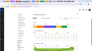

Sync FR245 with the primary device (FR165) worked fine. The FR165 doesn't support training status and training load, but after sync FR 245 they were interpreted by Garmin Connect. After April 13, I no longer see the training status (no status) in Garmin Connect, but I still see the training load. Perhaps a result of the latest beta (23.13)?
  • After running and cycling training last week, this morning my training status was shown again.
    My primary FR 165 (and FR 245) maximum heart rate was accidentally automatically determined, which was not my intention. I fixed the maximum heart rate more than a week ago according to the Spanous calculation (lower maximum heart rate). The change in the maximum heart rate has seriously disrupted Garmin's algorithm and was the reason that the training status was not shown for more than a week (no status).
