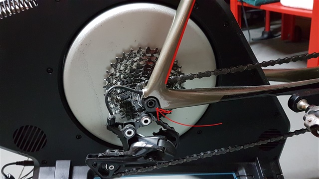

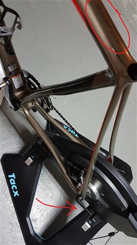

    Hello.
    I bought the same Cannondale Synapse Disc 105 bike a few months ago, and I have the Neo 2T.   The bike has a thru-axle (versus quick release).  This is the key part that connects the bike to the trainer.  Because the bike has disc brakes, it fits a little differently than bikes with rim brakes.  All parts needed to make it fit properly come standard with the Neo 2T.  You only have to purchase the rear cassette separately.  As you are new to it, I suggest you purchase the same rear cassette as what your bike has - probably the R7000 105 11 speed for about $80.  This will ensure your bike when on and off the trainer can be calibrated to shift the same.
    Hope that helps.

    0 Former Member over 4 years ago in reply to Former Member
    Maybe we're talking slightly different models.  My Synapse definitely has a thru-axle, as shown in the pictures.  Either way, the Tacx Neo 2T comes with the needed parts to make it work.  Have fun.
