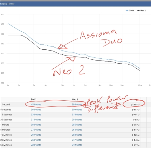

  • Here are the results. Tacx is constantly 5-10% lower than Assioma. ERG was off.
    https://www.zwiftpower.com/analysis.php?set_id=95308
    https://www.zwiftpower.com/analysis.php?set_id=95310
    I configured crank length for Wahoo Element Bolt in Wahoo Element app before those rides.

  • got it . Could You do the single leg drills also in these 2 comparisons?
    I think You can check your balance postride in the Wahoo history log (in the Bolt or in the App maybe under details, should be an avg balance value for the entire workout). If You dont find it, share the fit file here (in ZIPped format) and i can read it out easily.
