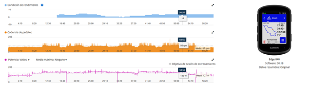

I have a 1 month old TACX NEO 2 T, I use it with windows TACX APP or with Garmin EDGE 840. Firmware in TACX NEO 2T is 2.7.0. EDGE is joined by ANT protocol to the trainer and I see a lot of cadence variation during workouts from a normal 90 rpm to as high a 150. I send a picture of a workout today were you can se cadence spikes. I have read it has to be solved by the 2.7.0 firmware but with it I´m experiencing the problem with it. Would it fix changing to a BLE conexión or there is someting I can do?
