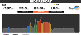

In test ride I had to warm up for 5 minutes (150W to 300W, I think). After that I had to do 450W for 1 minutes. When I kept pedaling at the same cadence, the power was going up to about 350W and not any further. When I increased my cadence to 105-115 the power when to 430W or so, but after that it dropped again to 350W.

This is what happens on Zwift:
