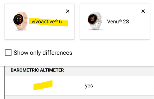

I purchased a Garmin Vivoactive 6 recently as my Venus 2S died. I noticed my new watch does not record floors and would like to know if there is something I need to update in order to record floors?
Unlike Venu 2S, Vivoactive 6 does not have any barometric altimeter:
I am very unhappy that the Garmin Vivoactive 6 does not do floor climbs. I upgraded from a Vivoactive 4, which did do floor climbs. I did not expect a removal of a feature from a older model. To me this almost constitutes misleading advertising. Who eliminates a feature and does not prominently announce this? I am very very disappointed. It is a bit after a month since I got the watch, and I thought the watch was simply adjusting to my biometrics. Now I find it will never count floors. Is there a remedy for this, Garmin?
I am disappointed too. Went from 4 to 5 and was happy but have problems with 6 also with steps and sleep features. XXXXXX
No, it does not have the hardware to record elevation. It's a shame that Garmin removed it. The VA4 had it, but then the VA5 and VA6 doesn't.
