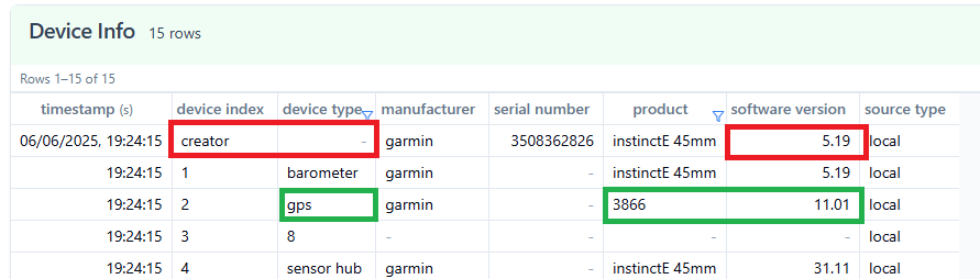

    Please open a FIT file using https://www.fitfileviewer.com/ and check "Device Info" for the GPS product number.
    This is my Instinct E, reporting the GPS product number as 3866 (Airoha AG3335MN) with system software 5.19 and GPS software 11.01.
    I'd like to know the GPS product number for the VA 6, and whether it is also reporting 3866 (single-band AG3335MN).
