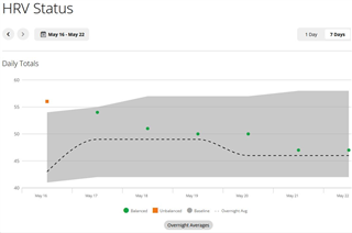

While the update fixed one problem (activity Icons, on the Body Battery glance, not updating) on my watch I’ve noticed that the nightly HRV average is not updating. I don’t think I’ve had the same HRV average 2 days in a row since I’ve owned the watch, but it was the same for 3 days in a row. I then did a soft rest (power off and back on). And, while I got a different average the next morning, it stayed the same (again) for 3 more mornings.
I contacted Garmin this morning, but have not heard back yet. As just about every activity and health metric uses the HRV data, I now have NO confidence in the watch.
I suppose I could do a power cycle every day, but that doesn’t seem like a long term solution.
If you have installed the update, the easiest way to see the problem, is to check HRV, using the Connect App.
Go to HRV Status.
Tap on 7D, to see seven days of data.
And then tap on Overnight Averages, which is underneath the graph.
If you have a similar problem, the graph of overnight averages (dotted lines) will be flat since you updated.

    I did a power cycle, before going to bed last night, and it updated.  I'm a little suspicious of the HRV Average number, as before 14.15 my nightly average would be all over the place, now it's been 49 (for 3 nights in a row), 46 (for 3 nights) and this morning it was 45.  Seems to good to be true!  :-)

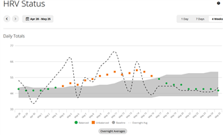

    Although, since update 14.15, it does seem as though my HRV does not change as dramatically.  The daily average used to have wild swings, from day to day.
    Look at the past 4 weeks of my HRV data.  The last several days have been remarkably “stable”.  I would have to say, based on the history, that it was too stable.  Only changing from 49, to 46, 45 and (last night) 48.
