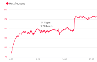

I am using my Vivoactive 4 and the Garmin HRM Run to measure the heart frequency.
While running activities, I see sudden heart rate jumps of approx. 35 ppm while keeping the same pace and load. This jump happens after 20 - 60 minutes within the activitc. Because of this, I had myself checked by a doctor (24-hour ECG, performance ECG, heart ultrasound ...), but everything was unobtrusive.

  • I think what you see there, is that the heart beat algorithm homes in on your running cadence instead of your heart beat. It happens sometimes for me too. I have seen it with a heart rate belt, but it is more common when using the wrist sensor.

  • Thanks for your reply! This matches with the observation a few weeks ago that this was not happening during a run with an increased speed.
    How do you handle/overcome this issue?
  • To get rid of the issue, the heart signal frequency must be stronger than the cadence frequency. A good fitment of the belt and wet sensor areas helps.
