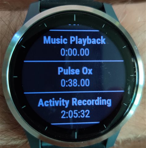

  • Former Member
    0 Former Member in reply to sensovision
    Which is this widget name?
  • it's named Device Usage but I seriously doubt it could be find openly in CIQ, you have to install BETA firmware to have it
  • I just wanted to tell for anyone who's curious about battery life. My battery drain per day with the new firmware was just 10%(no activities for today and default watchface), on average it's between 20-30%. So I'm not sure what magic Garmin did but it looks very promising, I hope it's not just some battery estimation glitch Slight smile
  • Just did a workout from the Garmin coach and on SW 5.80 I would get 5 seconds before the next step, every second a short vibration and then when the next step starts I would get a long vibrate.
    This is missing in the new SW.
  • What widget is this?
    ah, I think you're right, I think that right now there is just single vibration, I was running yesterday and thought that something is different but then discarded that thought, I'll pay more attention tomorrow.
    this widget is built-in inside BETA firmware, so you'd see it if install it on your watch.
