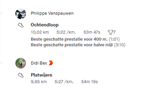

  • Voor ex. up mij friend, second me.  run under trees
    This one is ok because run on the road:
