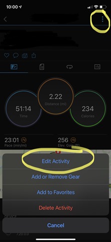

  • Hi Bryan, I amend mine in the app. Once you click on your activity that you recorded, if you click the 3 dots top right, you can then click edit activity and then this is where I manually input my miles based on what the treadmill records. I’ve attached a pic and circled the areas I mean in yellow. Hopefully this helps Slight smile . Nat
  • When you manually edit in the app it doesn't count in your total mileage for the day. I do different challenges and some of them are mileage based, so that stinks it won't count.
  • Oh I hadn't thought about that. I haven't tried a walking or running challenge yet. I know on the bike challenges, I edit the distances, and they count towards the challenge badges, but that's probably because the watch has no built-in way to estimate indoor bike distance without a speed sensor.
