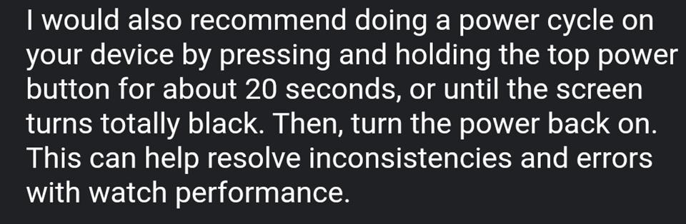

There is also another way to try but it does not helps after a while same thing happens again. Do refer to attached screen capture on the solution given by support
