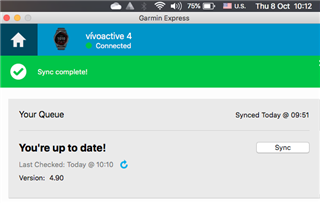

  • there is no update as shown in Garmin Express.
  • Where did you purchase your watch. Some Asian Garmin products don't receive the same updates...
