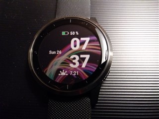

  • test continue: I'm on 65% after 76hours in smartwatch mode, 11% per day (https://photos.app.goo.gl/3ospAvrNjwtVycKp6)

  • on my disk, it's my watch face, optimized for my usage and VA4, no customization, everything is "hardwired" for best ratio performance/power usage (display seconds on high power mode - after B button press). But I have this WF and 4.00 only 3 days, so it's in test now.

  • Some pics to supplement my posts.
