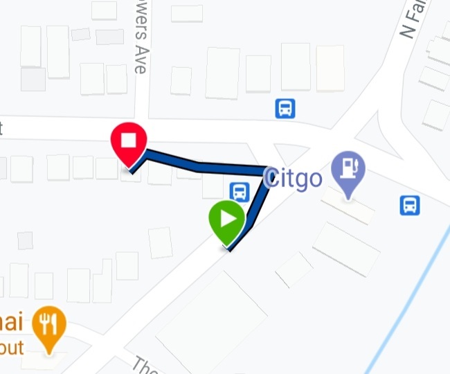

    I've had my watch for a month and am experiencing the same problems. The gps doesn't kick in until I'm about a half mile into my run and then randomly quits during the run. I switch the gps to Galileo + GPS today to see if that will change my tracking later today and if that doesn't work I'll try just GPS and if that doesn't work I'll just use a secondary phone app. It's really stupid especially since this is supposed to be a safety feature of the watch. Something which I find important as a female runner now with much less daylight to run in. One would think Garmin would try to remedy this problem since that aspect is compromised but clearly since people have been posting about this for more than a year the company doesn't care.  The attached image is what was tracked during a 5k that I was running....super accurate.
