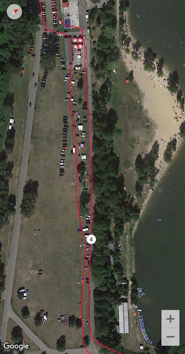

Before My vivoactive 4 I had a forerunner 245 which had great gps accuracy. It was spot on when running on a 400m track. The vivoactive is terrible compared to it. Ran 7 laps and it recorded 3km. Have tried both Gallileo and glonass but the track is almost always 10-20m off where I ran.
Anyone else has this problem?

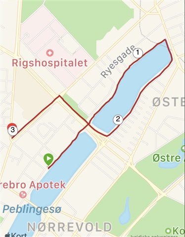

  • Is anyone still having problems with accuracy? Mine is always off by like 5m or so. On the map I'm always walking a few meters next to the actual path.
