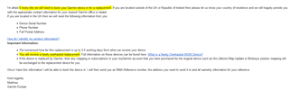

  • And, btw, we got this answer from Garmin Support
    We provided the data and I'm still waiting for the reply.
    Wondering also why a NOH device instead of a new one
    are you the one who sent also the feedback via support center? :)))
  • - I would follow up with Garmin Product Support if they are requesting the exchange. We do not have any NOH vivoactive 4 devices currently, so you would receive a new replacement. This seems like they are using a template and this information should have been changed to new device.
