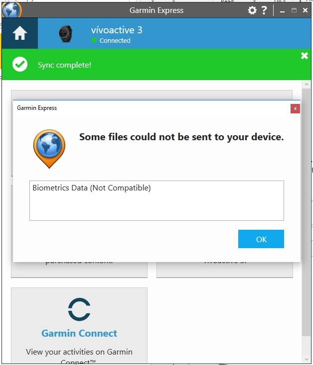

Hi All,
My VA3 seems to be stuck with an update queued that it is unable to complete. I first noticed on the connect mobile app that I was getting a red exclamation mark near my device after syncing and it said there was some server connection issue. I also noticed about this time (but it may be unrelated) that Physio Ture up did not appear to be working. Where I previously would get activities from my Edge 520 appearing on my VA3, this had stopped, but it may be due to a firwmare update or some other cause.
Anyway, I tried syncing with the PC and it is also unable to complete a sync, but I get more information (assuming the same issue??) and I have attached a screen shot to this post. I get an error that "Some files could not be sent to your device" and also "Biometrics Data (Not Compatible)"
I am not sure how to clear this issue. I don't know if it is causing the Physio True Up issue I have or not, but I would like to sort that out, as I like that feature and it is no-longer working.Other than that, the only real issue is the exclamation mark which is not a biggie if everything else works OK.
Any ideas on how to fix this?
Cheers,
Adrian ciq.forums.garmin.com/.../1403334.jpg
  • So further to this, it seems like an option to try to fix this would be to do a factory reset of the watch. The only problem with this is that all the settings like data pages for my activities will be lost. Is there a way to save these settings and then re-import them later after a reset to save me spending a lot of time adjusting all the setting back to what I like?

  • I also noticed about this time (but it may be unrelated) that Physio Ture up did not appear to be working.
    My bet is that they ARE related.
    When I hadf just one Garmin with Physio TrueUp capability, I never had to sync Biometrics data, Since I have both Edge 530 and Fenix 5+, after each of my activities made with any of these 2 devices I have to sync Biometrics data. So there is a very high probability that sending Biometrics data equals to the "enforcement" of TrueUp.
