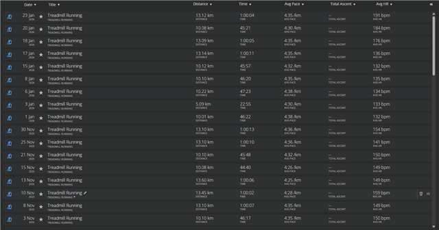

Has something happened to the average heart rate on the watch recently? I am a bit confused why mine is suddenly showing 176, 184 and 191 on my last 3 runs.
It also seems the rate from Jan 1 until the last 3 runs was too low. The attached screenshot shows my runs from Nov. I had a Venu 2 until the end of the year and as you can see, the heart rate is quite consistent at 140s/150s. Then, when I received my Venu 4 for Christmas and started running in the year it shows in the 130s. And then in last week has gone bonkers.
My assumption is a firmware update might have tried to fix the lower heart rate issue but broken it? Anyone with any idea? Thanks!
