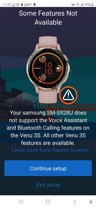

I can see the phone screen become active when I trigger the button on my watch, but I never get the triangle with the microphone on my watch face. When I look at the actual Bluetooth connection for the device, I can see the toggle for audio slide over into the on position, then it toggles off then back off then back on again before finally turning off for good and I get the message on the watch face telling me it can't connect to Google assistant.
I noticed that I have three categories for devices in my Bluetooth settings. Speaker, headphones, and other. According to research I've done, other means Bluetooth isn't quite sure what this device is and, it considers Garmin Venu 3s to be in the "Other" category. Is this the problem???

  • Samsung A34, Android 15. Voice assistant and call features are not working.
    Surprisingly, calls used to work on Android 14 — the problems only started after updating to the newer system version.
