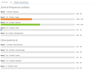

I cannot understand how running power zones work in Venu 3S... I have made sono RUN (out on un tapis roulant) and my running power zones are always without data or very few data. For example this is my last run:
Anyone con help me?
  • I'm having the same issue. The zones are similar to yours but my typical running power is way above zone 5. So it should actually say I'm in zone 5 nearly 100% of the time. But this would still be wrong as I can't sprint for 10k! On other devices you can edit the zones in the same menu as heart rate zones. But this option is missing on the Venu 3 and in the Connect app
