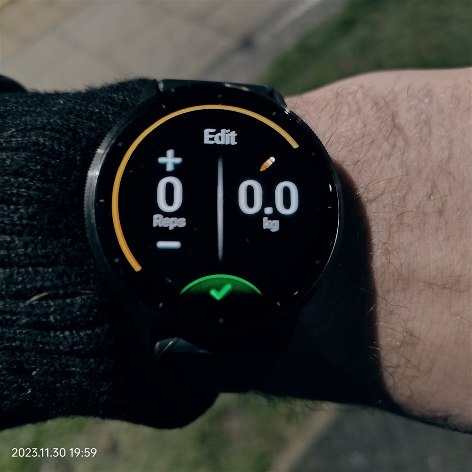

When I made workout by reps , first exercise when I finish they let me set how much reps I done and change the weights , but when I going second exercise not allowed fill reps

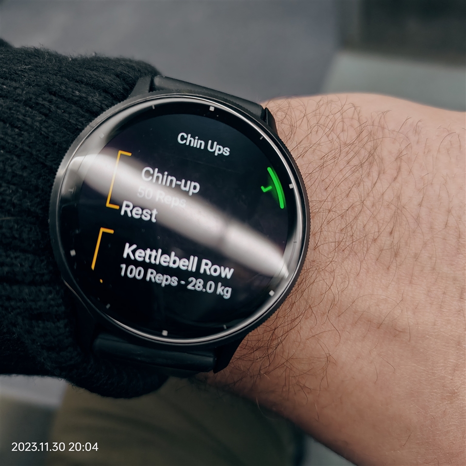

Do you have weight setup as manual for both exercises? Can you post a screen shot of the workout?
As a side question, are you able to get an accurate heart rate? It looks like your sleeve is blocking half the sensors.
I just showed example
Is there a rest after the kettlebell row? Hard to tell from picture. My strength workouts are typically as in the screen shot below.
I don't trust the rep counting feature, so I end the workout step with a lap button press. Usually the reps are correct, but if there is a rest afterwards, this allows me to edit reps and weight, if necessary, each time. This is done during the rest step. If there is no rest step, the watch would just go right into the next workout set or end the workout if it's the last step.
Yes is rest , after that row when I finishing second exercise it not let me edit reps like a first one
