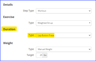

  • Remember that I'm talking about a programed workout with different excersices.
    Yes, exactly what I'm doing. When creating the workout, set it up like so...
    This is just one of the sets of an overall core workout I'm doing. All of the sets end with lap button press.
